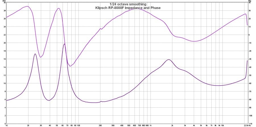

Alberto 237 Publicado Mayo 21, 2019 Share Publicado Mayo 21, 2019 hace 5 horas, Alberto dijo: habría que ver cuál es el sweet spot para amplis SET de pocos watts, digamos hasta 300B, dentro de la serie RP. Estos más sw o alguno de los que siguen. pillé esta reseña del otro extremo de la línea RP., el RP8000F y tiene un comportamiento similar al de estantería, pero todo ocurre un poco más arriba en la impedancia, según las mediciones del reseñador , encontrando también una mucho menor sensibilidad que la declarada: The above graphs show the electrical behavior of the Klipsch RP-8000F. Klipsch specifies this speaker with a nominal impedance “compatible with 8 ohms” which is a fairly ambiguous spec. I take that to mean you can safely use this speaker on amplifiers that are only rated for 8-ohm loads, and that is largely true. There isn’t much here that would be problematic for most amplifiers. The impedance minima occur at 160 Hz with 5.17 ohms, but the phase angle isn’t too severe. A more challenging point may be the port tuning frequency at 40 Hz which sees a 5.7-ohm impedance dip at a steep phase angle. That may be tough on feeble amplifiers if you crank them hard, but even an amp in a mid-range AVR should be able to handle these speakers without much of an issue. The use of a subwoofer here would make these speakers a much easier electrical load by alleviating the amplifier of having to power the port frequency range. What helps to make the RP-8000F an easier load than many other speakers is its above average sensitivity. I measured its sensitivity as 92.1 dB for 2.83v at 1 meter. That isn’t bad; it’s better than most speakers in this type and price class. However, it is significantly below what Klipsch specifies for it which is 98 dB for 2.83v at 1 meter. acá la reseña completa: https://www.audioholics.com/tower-speaker-reviews/klipsch-rp-8000f/conclusion de todos modos, tomando en consideración el precio, esta serie si se puede usar con SET provee un nicho de precio que nadie ofrece, con esta extensión de frecuencias también. No serán perfectos, pero vale mucho la pena hacer unas escuchas con el propio ampli SET- Citar Enlace al comentario Compartir en otros sitios More sharing options...
